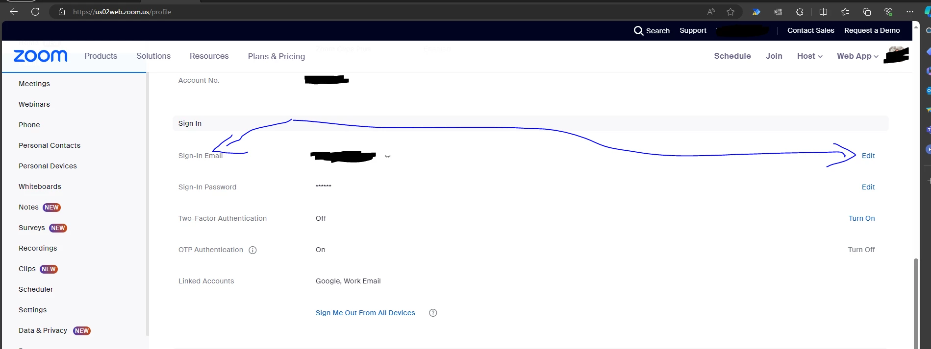

I did the following
1. Click on your account (top right)
2. Scroll down to Sign in section (see attached screenshot)
3. Edit that sign-in
Note at first it felt like it was going to create a brand new account and I cancelled the process teh first time but then when I did go through with the process all my recordings etc. remained and I didn't have to change anything :).
