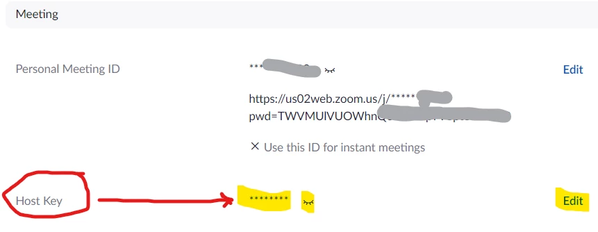

    • You Host Key is located on your web login to zoom.us on your Personal -> Profile tab:
    • Click the "eyelash" icon to view it.  Click the Edit link on the far right to change it.  I do recommend changing the Host Key "regularly", at least every 3 months.  Anyone with that code could claim host in any of your meetings where you were not present.
