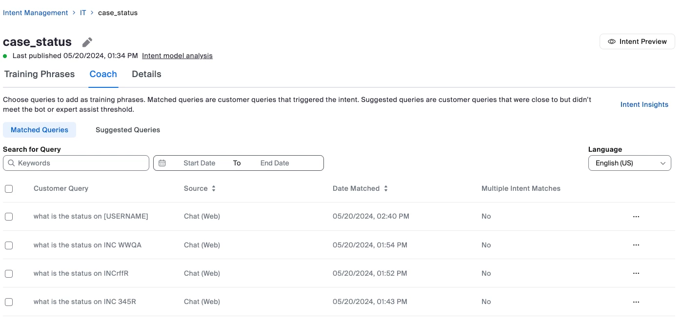

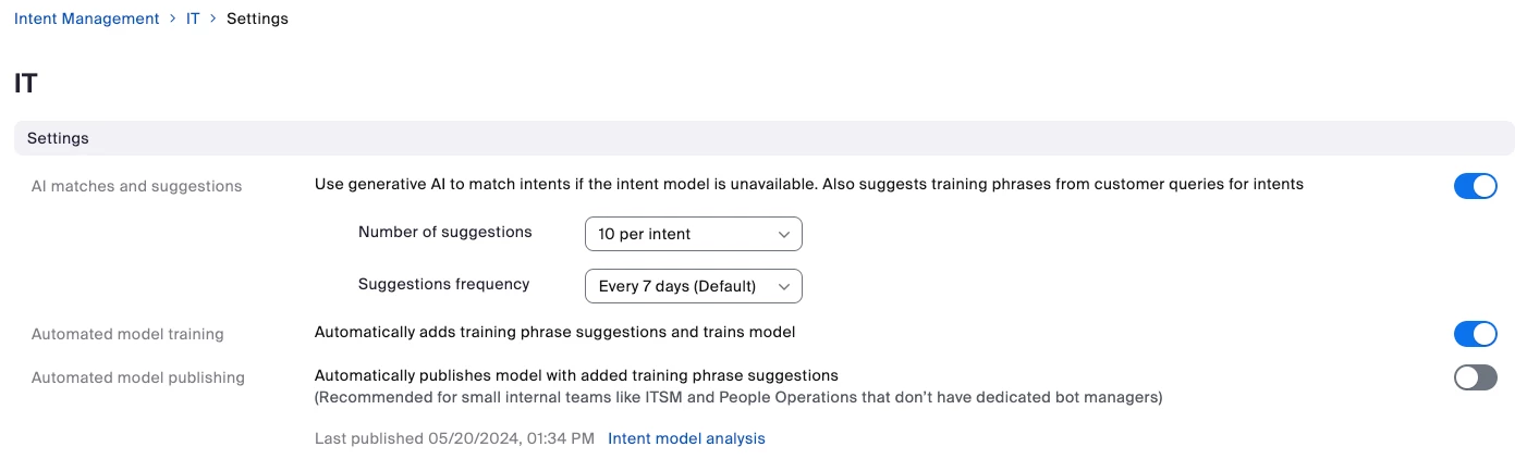

Coaching applies to historical queries. We have recently enabled the ability to use genAI to produce queries . Please look at the following two settings
1. Coaching settings : locate the intent and go to the coach tab
 2.  Using GenAI for Intent matching and suggested queries: Intent Management->intent group settings
