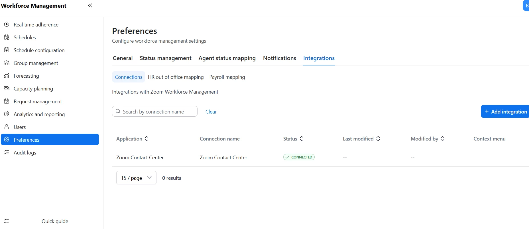

    How to verify the queues are configured or assigned to WFM ?
    M_AmeenAuthor
    Partner
    Aug 3, 2026 12:08 PM UTC
    Guys,
    I figured it out. Seems i was missing the integration with Zoom Contact center.
