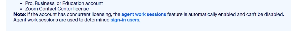

If your CC does not use concurrent licenses, you can disable work sessions. If you use concurrent licenses, then it is auto enabled.
https://support.zoom.com/hc/en/article?id=zm_kb&sysparm_article=KB0058399

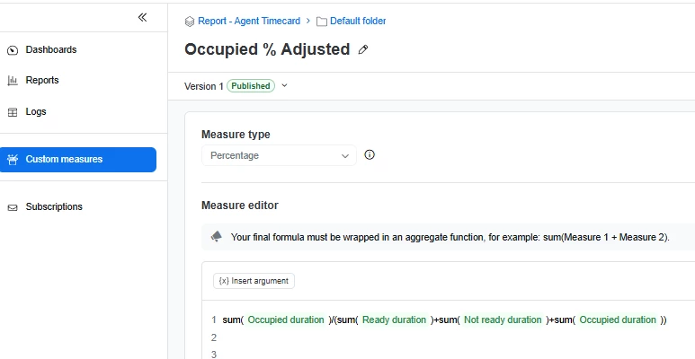

If you do have concurrent licenses, you can create custom measures for Agent Timecard (see screenshot below as an example for Occupied %). This doesn’t perfectly fix the issue, but it does help marginally. Neither % will fully be accurate unfortunately.

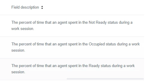

We have concurrent licenses, so I’m not sure what they use for the denominator when work sessions are toggled off! Work sessions are advertised as improving reporting and logs. I’d suggest testing outside of operating hours to see what happens from an agent perspective, supervisor perspective and impact on reporting. These are Zoom’s definitions in their data dictionary:
